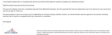

would sand lime cement render be suitable for sand lime bricks? Thing is gypsum have said their products arent suitable due to long term adheision and differential movement.

1960s build. Bricks contain lime and all I keep getting told is that due to the lime, gypsum products will not work including dab adhesive.
Some say SBR some say grit some even say Gyp line
