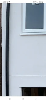

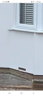

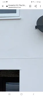

Having Issues with a costumer did krend job told him to get stop beads to go half way around the house and stop beads not bell drip beads he chose not to get ones for half way and got bell beads instead said I would do my best while putting on he said it was expensive but his block work was well pissed so asks me to follow block work to which I said it doesn’t really work like that asked for extra 25 bags top coat he got 20 wasn’t happy with finish so I’ve paid half on tc15 and primer put a tight backing coat on primed and topped out free of charge now when sun shines across it he is still saying that he doesn’t like finish

To be fair and honest it does look a bit shabby
And that's from photos so I would imagine it would look worse standing in front of it it
Hit and miss, not the worse job I've seen but nor the best.
What's going on with the bead details they don't look straight, and the odd bead under the bay window. It's easy to pick over other fellas work, but you've put your pictures up on a forum of renderers so expect gyp.

Are you saying you did krend mono first? And then to correct it - you've gone halves with the customer on materials and put a thin coat over it to sort it out?
Will take gyp no problem wanted to use stop beads from the off but he got bell beads which makes it hard to rub down to
