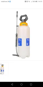

I've stared to use one of these ta damp work down gives it a light spray only takes 2minute when it full goes far
