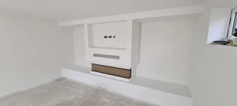

Finishing a 4 bed house tomorrow, will take some pics and add them here.

It's 725m2 and taken 18 days. Vaulted ceilings and media walls with fire were tricky and slowed things down.
