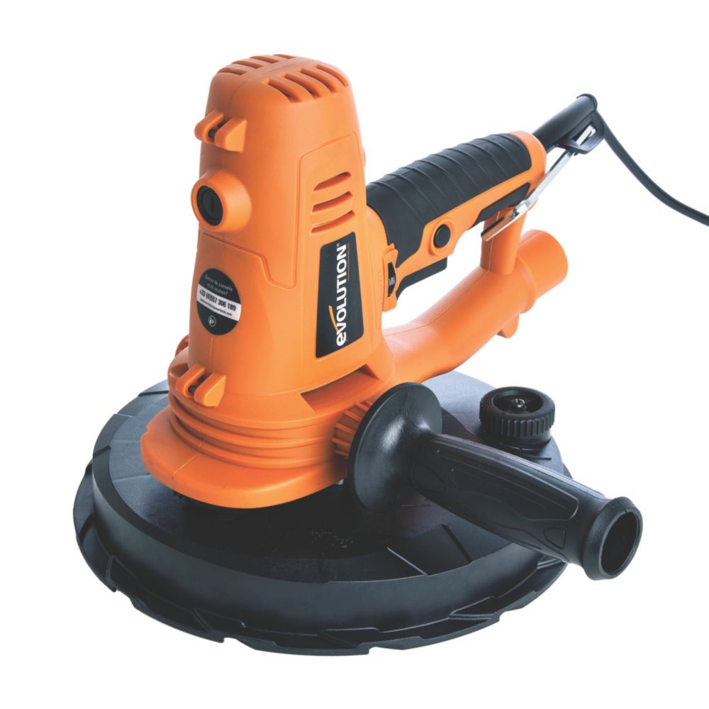

Run sander over with 80g mesh linked to vacuum. Takes the bulk of paste and any paper bits off.
Best neutralizer is gardz. You can use that, let it dry then pva but for me sanding is quick and simple and gives best surface.
Cheap power sander (150-225mm) head with power takeoff vacuum. Bodge together with waste pipe and tape.information on YouTube.
I also built a cyclone to collect dust..
Here is mine I built..
Full of dust
Pool hose.
Bread box
Cyclone off ebay
Waste pipe fittings
Couple to any vac

Just as @Wayners succinctly described; a good sanding is what I do. I do this as habit on most rough reskims. I just use my old pole sander, only takes a few minutes to do an average room
One of these is £70 from screwfix. Bodge on vacuum..80g disk..It's got to be clean dustfree environment. Live long and prosper ect
