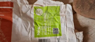

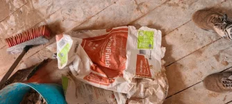

Any help on this because I can’t see any online that don’t have that green square on it as shown in the picture below.

The plaster isn’t setting fast your just slow as f**k put cream of tar tar in your mix
It’s an advert for fast set to make sure everyone knows it exists
Your plaster is not setting fast (unless it’s out of date?)
your time is probably flying by quicker than you realise
