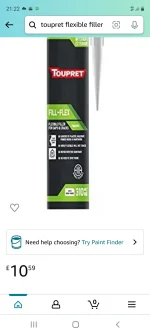

Hi my walls cracking dot and dab most off house been boarded over old plaster but sound plaster you fill gaps with anything paint it it cracks with in few days like it pusses filler out wards any ideas different plasteres and definitely skrimed and ova

@Topspread16 wasn't this 7 quid odd last week. @Markbaxter fill it wipe it of as it can't be sanded . Then top it with some sandable filler .
Let me know

The only way something could be pushed out would be if there was pressure behind or, (comma), the sides of the crack being sqeezed together.
Insufficent dabbing might allow the boards to flex, or more likely - you've bought a lemon, a house with frequent structural movement.
I recommend you employ a chancer with a large bag of Easifill, and sell it quick.
