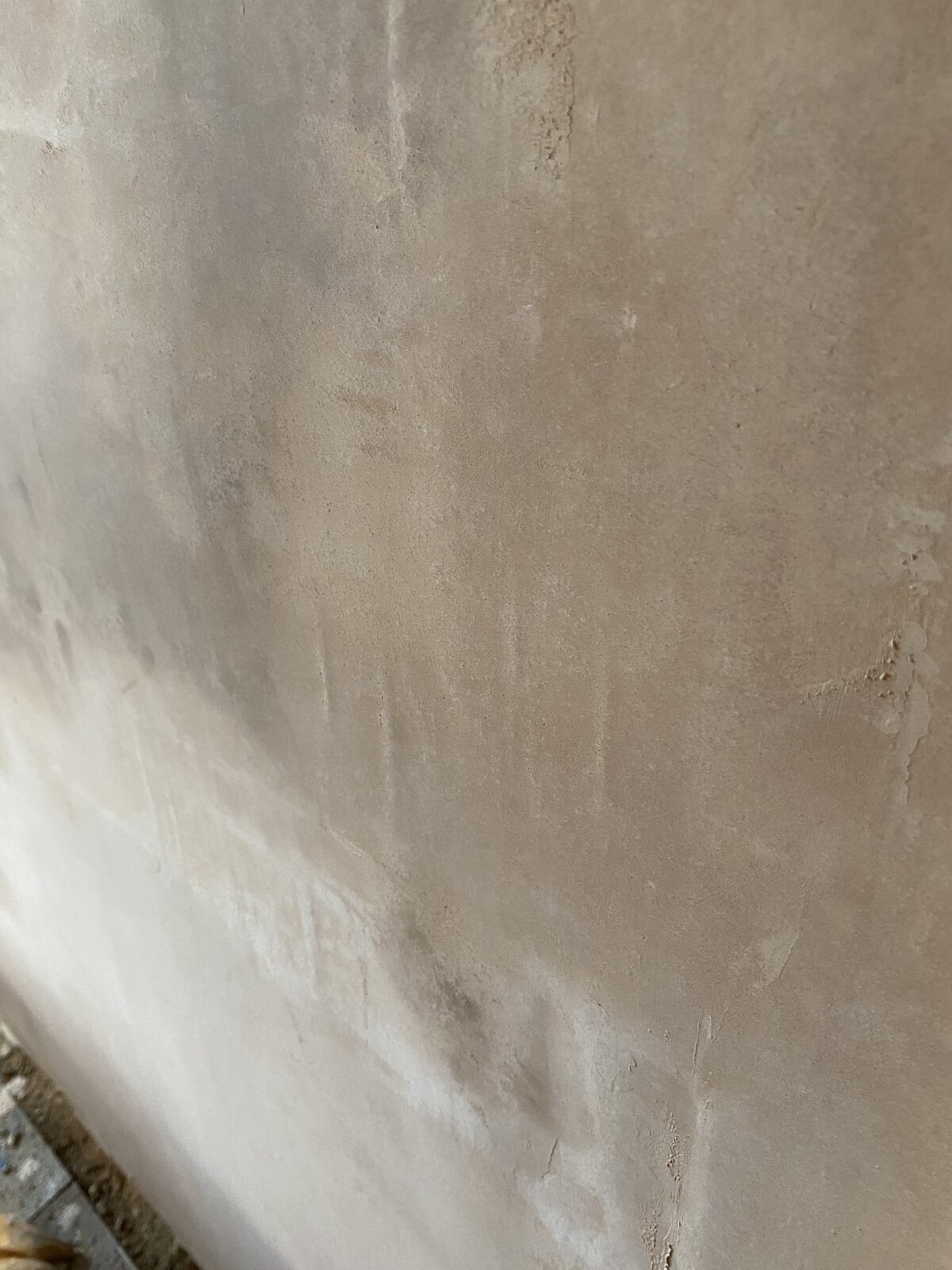

I have had my house plastered and I think some of the work is not great. Before I chat to them on Monday would love some feedback.
1) chunks of plaster have dried on my window frames and won’t come off. They even got plaster on my router and smart metre.
2) there are ripples on the wall. Not everywhere but in places. If I run my hand over it’s not smooth in some places

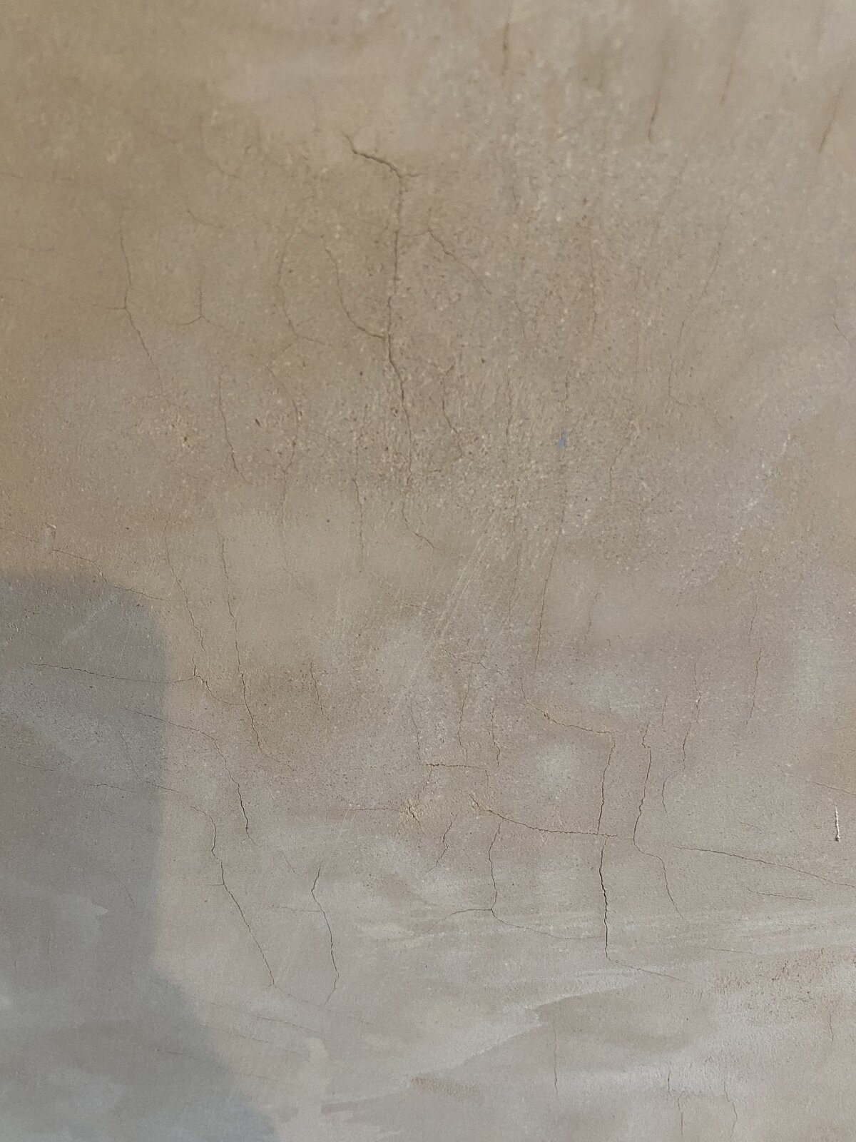

3) there are many hairline cracks (maybe some a tiny bit deeper). I think this might be normal and given it’s an old house?

For example is this marks from the trowel!?
Any advice welcome or am I just being pedantic

Apart from the bit he misssd by the light switch looks dandy mate
Crap plastering by muppets.There should be no cracks whatever the age of the house, they obviously dont understand blue grit doesn't stop suction.

Dreadful work, absolutely no care taken at all.
All these bad plastering threads contain the same basic errors time after time.
Sockets and switches either plastered into the wall or the plaster around them incomplete.
The Sockets and switches unprotected and covered in plaster.
Skirting and facings left uncleaned/protected.
Wall and ceiling angles poorly executed ie gaps, brush marks, uneven etc.
The wall's and ceiling surfaces covered in trowel marks, water marks, ripples and misses where the coats haven't been closed in properly.
Surface cracks (crazing) due to poor suction control.
These are all basics that any component plasterer wouldn’t leave.
