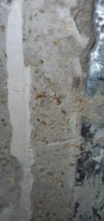

Hi All, new to this.
Just seeing if anyone knows what this old plaster is. Looks like it has shiny bits of gold in it.

looks like vermiculite flake and the plaster it's in could contain asbestos tread carefully, needs investigating
