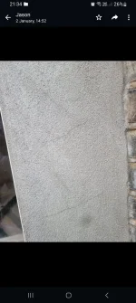

I have been plastering for about 15 years. I do the occasional rendering job if it's not too big as I work solo. In the last few years I am having constant issues with the top coat of my sand and cement render shrinking, with small hairline cracks.
The mix I am currently doing is:

On existing painted render, thermalite and engineering bricks I do an SBR slurry 2:1 cement to sharp sand. On high suction backgrounds I try and soaking the wall as much as possible. I also use pink Weber mesh on cracked walls.
I understand rendering is not a great idea in certain weather conditions. It's such a shame as I enjoy doing it but very disheartening when a nice job is spoiled by cracks, its got to the point where I'd rather just work indoors! Hopefully someone can tell me where I'm going wrong?

Had a look on here but can't seem to find anything. I'm just after a bit of advice. Thought I'd done a fairly decent job. Gutted to see shrinkage but I'm assuming the top coat is drying out too quick

Don't use mastercrete for external render. A builder I worked for used to get it and had similar problems. It would rub up mint then next day little cracks would appear, drove me nuts. After trying allsorts went to ordinary portland cement and everything went back to normal. Whatever additives they put in it must make it shrink.
Funny you should say that as I used rugby cement on a different area and it's absolutely fine. Would never have put 2+2 together though as mastercrete state that their cement is suitable for render. So thanks for that

Potential schoolboy error..
I'm always paranoid about knocking the beads out of plumb/level so I usually put them up after I've done the scratch. But where I have to bring certain beads out I'm potentially increasing the depth for the top coat, thus having to put it on too thick. Would this cause shrinkage?
Guttering is covering the very top, hence the screws. Tried using an arch bead but struggled to make it stay put, was a bit springy over such a short distance

Massive thank you theshed. Cut out the mastercrete and switched to general purpose. No shrinkage whatsoever. Had no idea about the additives in it so would never have guessed where i was going wrong

spoke to soon
This wall took all day to go off so surely can't be drying too quick..
I'm stumped
