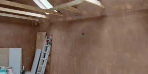

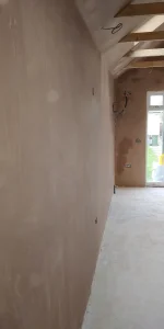

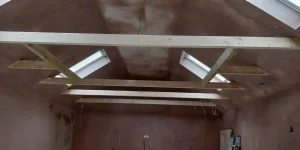

All done today.
I liked that they taped the upvc frame to protect it from splashing skim and also scored the bit where the door frame meets the reveal, but left tape on until after painting. Apparently that will stop the plaster on the reveal being ripped off as the tape is removed and stop the plaster on reveals from chipping as the door frame expands/flexes. Nice touch.

All done today.
They forgot to board the ceiling

Looks fine. I trust as you knew they were so cheap and did the few extra nice touches you gave them a few extra quid each to get a beer?

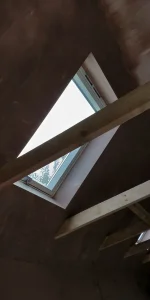

It's a good finish, smooth as baby's backside. Plan to have all veluxes slightly ajar and doors wide open during the day.
Hoping to get some paint on this Saturday. What do you think- too ambitious?
Maybe with no heater in there.

You should be alright for emulsion mist coat at least , when lifts are on and in daylight you can fill or sand any rough spots that catch your eye ,
  • Like
Reactions: Mos
Don't start slapping it on if the walls are dark , paint may delaminate
