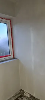

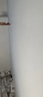

Because the bags are nearing the end date, within 1 ½ hours, whether that is ideal or not depends on the plasterer. I however use something to dope it, and its not that Extra time that is far too expensive.How long that set take then?
If you don't dope it, mix only one bag, that will cover the same amount as 2 BG bags. Only one coat, definitely do not 2 coat it, thats a scam to use more.
My process is:
Not doped: Apply 3mm +, run the spatula over it straight away after cleaning bucket. Then, instantly flatten it and get all lines out. Then, instantly polish it with water. But you want it all to be one colour (greyish). Takes a bit more effort to polish that BG. If you make mistakes or dents etc. Just mix a small amount and use it as filler, one strike and done.
Doped: Only use a teaspoon or your preferred item. Follow the same process as above but with time in between.
It can feel soft and you think I'll give it 10 more mins, all I'll say about that is, just test run a trowel over and see what you think.
I've seen on this thread the 1st batch was shite, I'm honestly 90% to mastering it. If the 2nd lot is a better mix then it'll be, hands down, superior in every way to bg.
BG stabbed us all in the back this year, and if we're honest, their products dry too fast in the summer, it tears, shrinks like f**k and the reat of its problems we ALL know about and will admit inside.
Everywhere MG product is imo superior except the boards. Avoid their plaster boards:
They come rippled to f**k
They snapp and aren't reinforced
Crumble
Just pure garbage, the ripples show through when you use even BG products on them.
Another thing to add is, MG finish has great body and levels out shite walls 10 times better, even 1 coat, than BG.

Its not the window its the blockworkwho the f**k measured that window?
