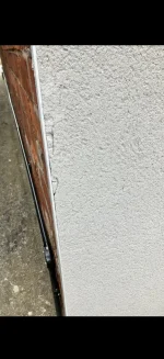

Hi,
I’d just like some advice on this eco rend monocouche job on a Victorian property I have been to look at. To me it looks like very poor workmanship. The render has only been on for just over two years. What are people’s opinions?
Thank you for everyone’s time

Not great
Not great at all
That said - looks like it been clumped and hit since completion
I don't think mono is recommended on that slope (main image), an incline like that, no manufacturer would guarantee it.
