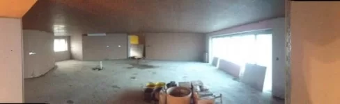

I find using a speed skim helpful when on my own ill knock up 3 1/2 bags put on a good coat then go round with speedskim gives enough time to wash up then put a trowel on it wait to pick up sponge it then couple finishing trowels with your choice I prefer metal sf finishing rule then plastic for final polish. It's like any new tool in plastering timing is key if you get on it at the wrong time you will have trouble and if you don't keep it clean you will struggle. As a two man gang we managed to get a 110m2 ceiling on in one go with fantastic results due to the speedskim it gives you more time which allows one spread to drop back and flatten in while one keeps putting on obviously you have to be a competent plasterer to start with but it certainly helps our gang on price work. View attachment 2637View attachment 2638
If we're on ceilings look in corner of room on pic we have a extendable pole which we attach the speedskim to and flatten off your feet and with the sf coming out you can finish it off your feet too. Just be patient with it and try different times.
