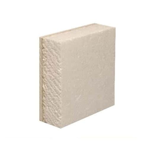

Think I'll need to hack off back to the blockwork to make room for insulation, and even then will only have 30mm to play with. Has anyone used the Gyproc Thermaline Basic 22m insulated plasterboard? It gets mixed reviews online...

Any thoughts on the door reveals? And does anyone have any experience with that insualted plasterboard I mentioned: 22mm gyproc thermaline basic:
Absolute complete and utter shite. Need a decent insulation board or it's completely pointless. That's 13mm of polystyrene stuck on 9.5mm plasterboard. Thin, flimsy and a waste of money.
