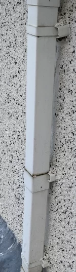

  • The downpipe hadn't been removed so they had attempted to render with it in place leaving a flat area without any stones and a number of holes through to the original render which to me means water ingress and problems down the line
