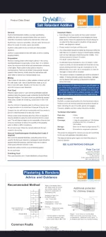

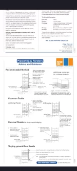

I had a damp survey carried out by Rentokil, a well-reviewed and reputable company. They identified a rising damp issue that needs to be addressed and quoted me for a chemical DPC injection along with re-plastering. While I’m happy to proceed with the DPC injection, I’m wondering whether it’s worth having the re-plastering done by them, as it’s quite expensive and I could get it done cheaper elsewhere.
Rentokil requires the plastering to be done to their specifications (please see attached) for the 30-year guarantee to remain valid. Do you think it’s worth using my own plasterer and saving a significant amount of money, even if it means forfeiting the guarantee? Or would it be better to go with Rentokil for the plastering as well

Sorry that's too small to read on my phone, even when enlarged to the max.
