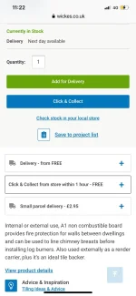

I’ve spoken to the customer this morning and he says it’s printed on the boards “Render ready”
Why is this if they are for interior use ?
Wickes have come back to the customer
Saying these boards can be used externally
So now the question is what can be used ?

Thanks @martinemj . We have both thin coat solutions and lightweight monocouche systems designed for render carrier boards.
We would need to see data and test sheets from the board manufacturer to determine if this is suitable to receive render or even if external use is permitted. Fire rating being a huge factor as well. They are many great boards on the market and there are also some that are not. Always get the data from the manufacturer, I've seen some nightmares in my time and its a costly thing to put right.
