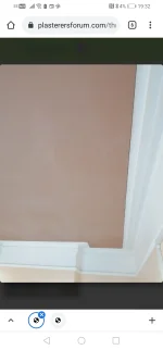

Hello people,
I’m an ex plaster and I re doing the front room of my house I thought it would be a good to over board the ceiling as lath are cracking and run a fresh mould over the original solid cove however I have really struggled getting a decent finish in my first run because the casting plaster keeps going off in about 3 minutes could someone point me in the right direction as I need to get bigger areas run and I know that it will look terrible….. I could do with a bout 15 minutes delay on the cure/set period

Unfortunately I have s studded the joining wall to sound proof next doors dogs lol so completely lost the previous solid cove moulding.
I purchased fine casting plaster from industrial plaster supplies website the bag has a date of 16/05/21 I assume this is the manufacture date as it is absent of a use by date.

probably where I have gone wrong then I have used casting plaster straight from the bag not like putty added I best head to the merchant in the morning
