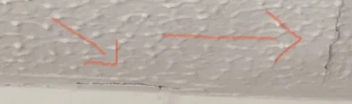

Please find attached image showing some cracks. Is it still possible to skim over the artex?

Looks fine to fibre tape over and skim, the plasterer will or should check it when they come over to quote. Point it out to them. He should check it to make sure it’s solid and isn’t blown or bouncing and as long as it is then it can be taped and skimmed. If it’s blown and come away from the board underneath then it will need to be removed.
