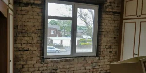

Making progress...
Now, for the Insulation what's the correct way forward:
Baton out the wall with 2x1, infill with Kingspan, 12.5mm pboard over the top.
Or
Dot n dab 37.5mm thermal boards?
I'm leaning towards the baton option as I'll save a bit of space (I'm fighting for every cm as there's gonna rads either side of the window and they're gonna prevent the wardrobe doors from opening fully if the rads end up standing too proud off the wall)

Buy sheets of EPS at the required thickness and stick to back of plasterboard with pva , then foam dab

Building regs would ask for 50mm insulation plus board, but your house so do what you will.
Hate insulation, interstitial condensation issues. You don’t have trickle vent in window either. Just dot and dab it and crank heating up in winter
You know what mate, I reflected on what you said and you're right.
I gotta get out of the mindset where I feel as I'm losing more sq ft by having more Insulation. Instead, I should be feeling pretty good that where the wardrobes are in I've actually gained 50mm of premium space because the clothes will hopefully provide some insulation.
So I'm going with 50mm as per regs.
The windows will be replaced so I'll have 3 trickle vents across two different Windows on different aspects of the room, so hopefully enough ventilation and room warm enough to carry the vapour rather than it condensing through the thermal boards. I was still thinking of using 2*1 batons and cutting away an inch off the 2" insulation to lap over the baton. So, its a continuous layer of insulation, but just 25mm, not 50mm over where the batons will be.
Bit faffy, but saving of nearly £300 over getting someone to d&d with proper insulated pb. This is based on me batoning & boarding diy.
Incidentally, where's the cheapest place to get foil-backed thermal pb?... Im.seeing them at around £55-£60/board whereas a 50mm sheet is £30+ £6 for pb. If I can close the difference in price, d&d will be the way forward. I like @bof your suggestion of foam dabs, but will need to check with the Spread if he is comfortable with that method.
Your time is £free so go for the faff style
Most site practice has saving time (which is labour ££ time) at it’s core value and is not always the best method but quickest method. Evo stick foam is amazing stuff for boarding but if your not familiar with it you may have it go off too quick for your speed level or find you have not bought enough and find out half way through putting your boards up...
