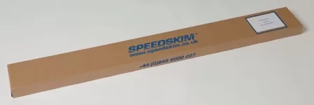

Thanks again for the purchase mate. Its worth taking a look at the Speedskim Introduction & User Guide link which would have come through on your automated payment confirmation.
Hopefully you have seen it but for others,when you purchase its a useful quick reference 'how to' guide which covers all Speedskim applications, together with blade change tutorial and recommended tips on care & maintenance.
I hope you liked the presentation of the Speedskim transit box. The pole attachment probably came in a white box (temporary arrangement) - going forward these will arrive in padded bag inside a courier poly-bag rather like when you receive an iPhone.
Hope you get on well - if you need any technical input or additional info please give us a call or pm..
