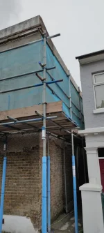

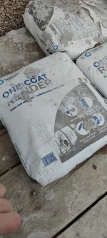

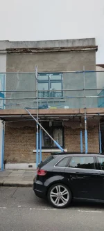

Hey all.
The guys used PVA as primer and mixed in PVA with the render I assume, photos attached. The manufacturers guideline states to use SBR. Hired this guy, family run business for external render specifically. I question the work as the agreement included mesh. As I can see on site, no mesh was actually used.
Don't think this job is going to quite work out.

Hey all.
Thanks for all your responses.
Michael
Oh dear.
Reply from the guy:
The mesh won't go on the top untill the base coat had dryed properly I just text the guys a the base coat is about 25 mil it's different thicknesses in different places because of the damp I don't think you understand that ! they was going to apply the last coat and the mesh when that's dryed it would be 2 layers down below to make up the thickness ........and probably one or 2 at the top but like I say it's not drying out ! Because when it rains moisture is getting in from different places because the top is no good .......
Anyone else would just render it and go.....then your render would come away in how ever many months I've been trying to explain to you the issues........
