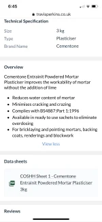

I always add 1 sachet of Entrainit to each mix, 1:5 float in one application, straightedge horizontal then vertical, fill in any hollows, edge again then when flat & plumb leave until firm then I cut in the wall/ceiling function to make it sharpe then I devil-up, then run my trowel over the wall to lay down any snots, leave it for about 5 days then skim. I then move back to the ceilings and scrim the ceiling/wall junction and set the lids. I’ll float S&C all day and devil-up at last load an hour before knocking off. If the floating has dried out I just spray with water to control suction. :)
