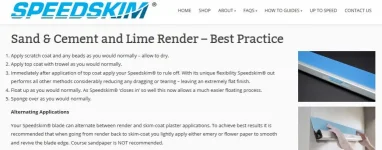

Taken from speedskim website, number 3 craics me up in regards to render, i just cant take them seriously lol
" Immediately after application of top coat apply your Speedskim® to rule off. With its unique flexibility Speedskim® out performs all other methods considerably reducing any dragging or tearing – leaving an extremely flat finish. "
A bit contradictory ! surely theyre not saying it rules off flatter than a rigid feather edge ?
