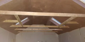

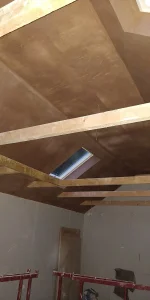

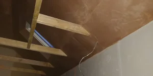

They were in, but a slow day me-thinks (I could be wrong- they do two coats so perhaps that's why it took longer to even the undulations between rafters and to get the lines straight etc)
Just the splays and velux reveals done today. They're back tomorrow...

Its a little bit raggety , however you are lucky, because that is (considerted the high end) of work these days ! Sad but true ! The men on here know what im saying , it is a shame, but it is what it is !

Cant judge on it at that point of it drying .. you got to think @Mos They have to get the gear up there and work round beam
